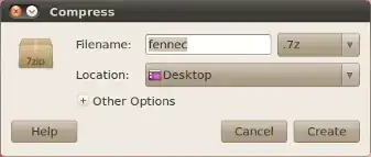

7z (when the password option is used) uses a 256bit AES encryption (with SHA256 key stretching).
Install it (p7zip-full), right click on a file or directory you want to encrypt, and choose Compress, .7z and Other options /Password.
For decryption, right click on the .7z file and choose Extract here.
