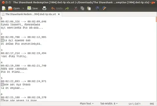

I downloaded a Greek subtitle for a movie, and this is what I see when I open it with Gedit.

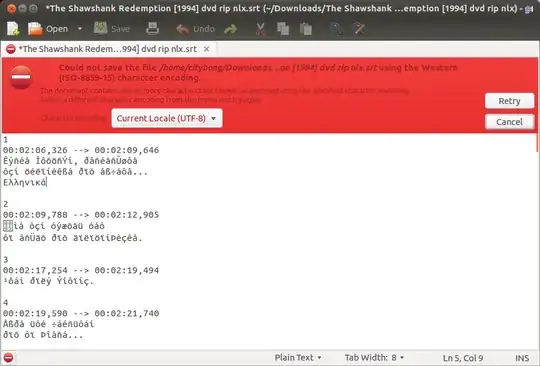

Subtitle works great on VLC, all perfect. But what if I want to edit this subtitle with some Greek words? I instantly get an error about character encoding.
I hit retry and then VLC doesn't recognize the subtitles...

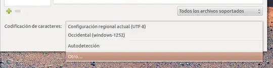

  1. Open Gaupol and go to menu FileOpen or click on the button Open.
  2. There is a selection menu in the lower part of the open window, titled Character encoding. Click on Other... (last option).
    Character encoding option in Gaupol's open window
  3. Select an appropriate encoding for your file, e.g. Greek ISO-8859-7, and click on the button Accept.
