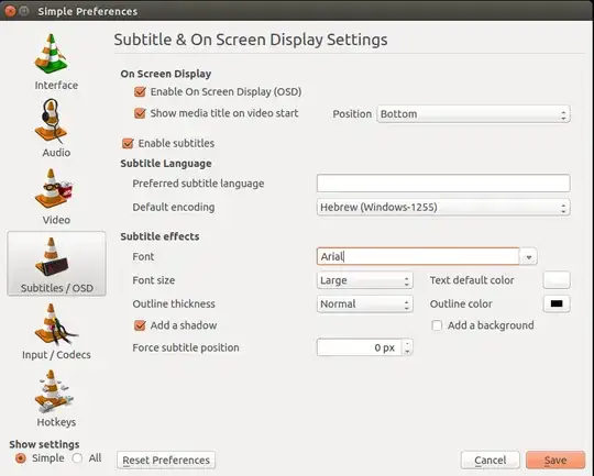

Had the same issue with heb sub here is what I did,:
installing Hebrew fonts packs:
sudo apt-get install culmus xfonts-efont-unicode xfonts-efont-unicode-ib xfonts-intl-european msttcorefonts
restart VLC and then choose Arial as the font and Hebrew (Windows-1255)
