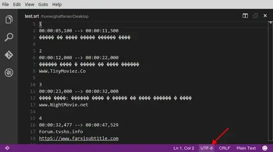

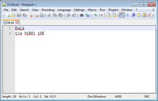

I frequently encounter text files (such as subtitle files in my native language, Persian) with character encoding problems. These files are created on Windows, and saved with an unsuitable encoding (seems to be ANSI), which looks gibberish and unreadable, like this:

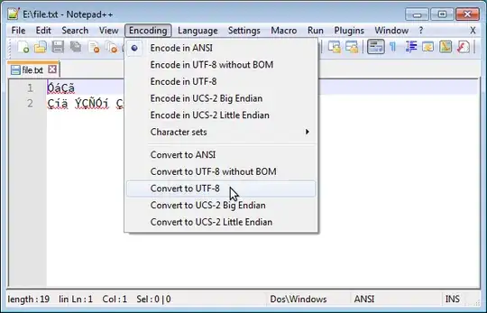

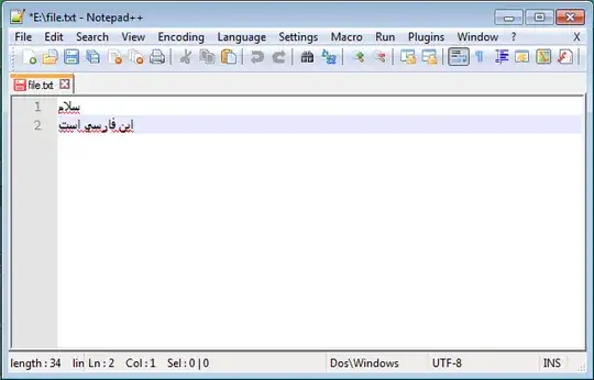

In Windows, one can fix this easily using Notepad++ to convert the encoding to UTF-8, like below:

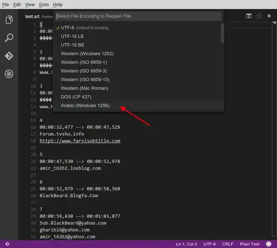

Open the file you want to convert its encoding in VS-Code. At the bottom of the window, there are a few buttons. One of them is related to the file encoding, as shown below:

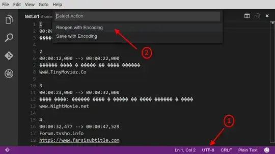

Clicking this button pops up an overhead menu which includes two items. From this menu select the "Reopen with Encoding" option, just like below:

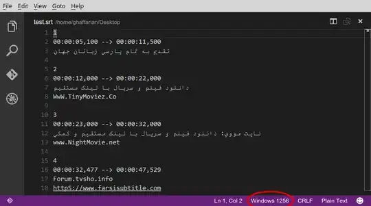

This will open another menu which includes a list of different encoding, as shown below. Now select "Arabic (Windows 1256)":

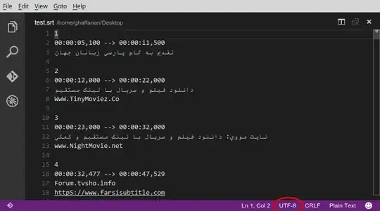

This will fix the gibberish text like this:

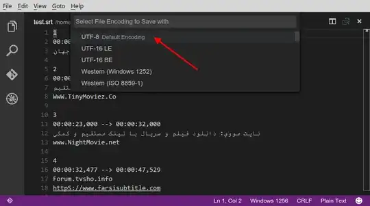

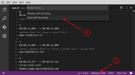

Now click the encoding button again and this time select the "Save with Encoding" option, just as below:
And in the new menu select the "UTF-8" option:
This will save the corrected file using the UTF-8 encoding:

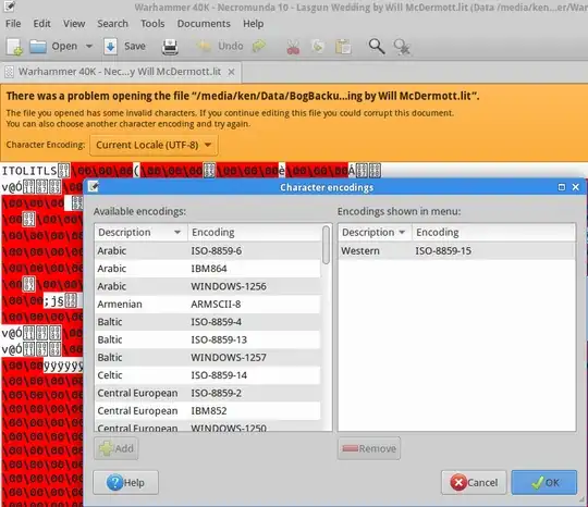

I don't know if this works with Farsi: I use Gedit, it gives a fault with wrong encoding, and I can chose what I want to translate to UTF-8, it was just text not lit format, but here is a screenshot!
Sorry I finally got through my text files, so now they are all converted.
