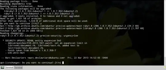

The nearest thing to what you are looking for can be had with a package called apt-listchanges, which will give you a changelog summary when you upgrade packages. You can set it up so the changelog notes appear in the terminal directly after apt-get downloads the upgrade (see below explanation and screenshot), but before you install it.
You can install the program with
sudo apt-get install apt-listchanges
and then set it up with
sudo dpkg-reconfigure apt-listchanges
The setup file created is /etc/apt/listchanges.conf.
My setup has the changelog information being shown directly as text in the terminal (stdout), which is just what you wanted. I find this is better than having a pager load up the information. I just have changelogs selected in my conf file, so the news about the package is not shown. I have also set it up to email root the excerpt of the changelog. You need to set up local email by referencing my article here if you want to use this feature.
This is my /etc/apt/listchanges.conf:
[apt]
frontend=text
email_address=root
confirm=1
save_seen=/var/lib/apt/listchanges.db
which=changelogs
A screenshot of the upgrade procedure when apt-listchanges is installed. I have set it to ask me for install confirmation after reading the changelog excerpt.
For more information see man apt-listchanges and the Ubuntu manpages online.
