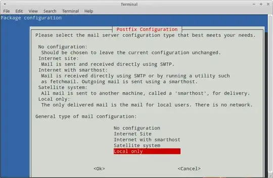

Postfix is pretty straightforward to setup, although you may have some particular settings that you wish to apply. In the first screen you see below, you must choose the local option for your mail:

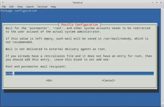

When it mentions /etc/aliases and the Root and Postmaster recipient (as above), you can fill in your user name, but make sure you check your aliases file is as it should be by reading the next section of this tutorial.

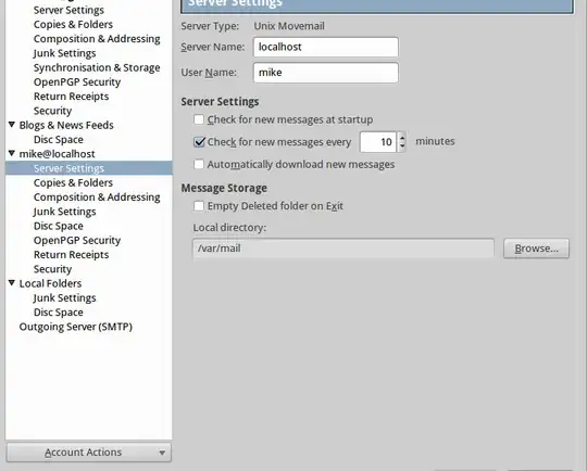

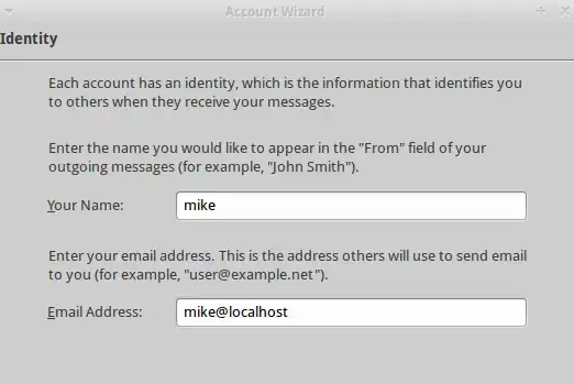

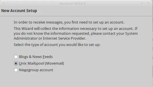

Now for the Thunderbird configuration. Go to edit > account settings > account actions > add other account > select Unix spoolmail and in the next screen put your username in the first box and place yourusername@localhost in the second box.
Now, go to your new account in account settings and select server settings and select the local directory as /var/mail or /var/mail/username (if setup), as in the screenshot below.

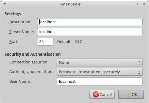

As per the instructions in this article you will need to configure the smtp server if you want to test the account by sending a mail to root@localhost and then clicking get mail in Thunderbird to receive it, as root's mail is being redirected to youruser@localhost.
Go to account settings > outgoing server and choose to add a new one. The settings should be as in the screenshot below:

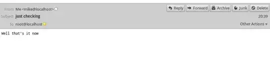

Now, finally test your account by composing a mail to root@localhost and then a few seconds later clicking get mail on your account. You should see an email like this:
