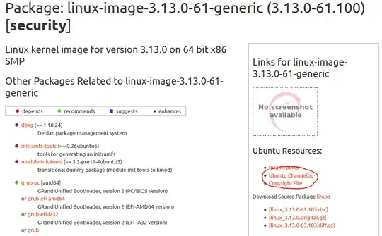

As you already found out you can find the packages that require a restart in /var/run/reboot-required.pkgs
Now you just need to look in the changelog of the package to find the information you are looking for.
  • If you are already on the machine you can find the changelogs in /usr/share/doc/${package_name} (example: zless /usr/share/doc/linux-image-3.13.0-61-generic/changelog.Debian.gz).
  • Debian provides some tools like apt-listchanges to make this more convenient (1, 2, 3).
  • Another way to do that would be to use packages.ubuntu.com.
    In your case:
    image showing where to find the link for the changelog on packages.ubuntu.com
