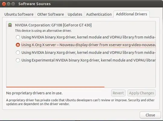

Also you can search from Additional Drivers page . In example below , no proprietary drivers are in use
