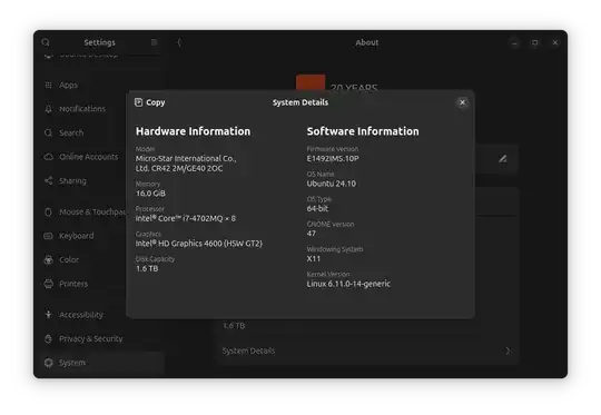

I have an old MSI GE40 2OC-218USK gaming laptop that I've posted about in the past. I let the updates lapse (it was on 23.10) so had to do a reinstall. The install of 24.10 went mostly fine, except for known issues (that I always encounter at least) in the installer, that forced me to do an offline installation without pulling down nvidia drivers and updates, thinking that I could do that afterwards. When I booted into the system though, it shows the graphics as the Intel HD graphics, which is the integrated graphics that's part of the CPU (an i7-4702MQ) not the GeForce GTX 760M, that the system comes with. Ubuntu About System Dialog. From a quick google, it said to try logging into the desktop environment with Xorg and not Wayland, and that did not change anything for me.

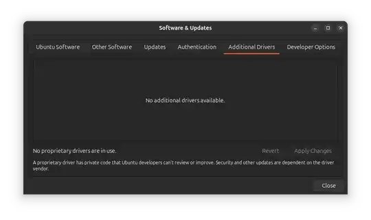

In earlier installations of Ubuntu, it did detect this GPU successfully and install an appropriate driver. I don't know when it stopped doing that, but it doesn't do it anymore. When I go to the Additional Drivers dialog box, it's not detecting the GPU, and is not pulling up the appropriate closed driver for for the GTX 760M.
Additional Drivers Dialog
