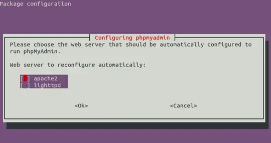

Adding to @thomasrutter answer:
Just in case someone doesn't know this (i didn't for sometime), after running this command to reconfigure phpmyadmin
sudo dpkg-reconfigure -plow phpmyadmin
this screen will appear in your terminal, make sure the * is there inside the brackets [] like this [*] for apache using the Space
