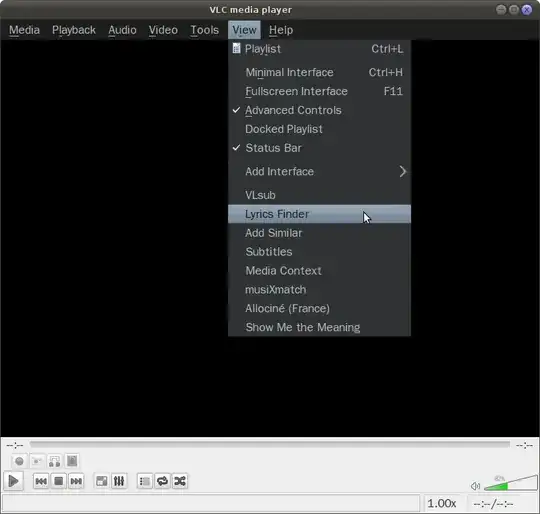

Once installed, they are to be found under 'View'
(I put them here for illustration, I do not recommend all of them.)

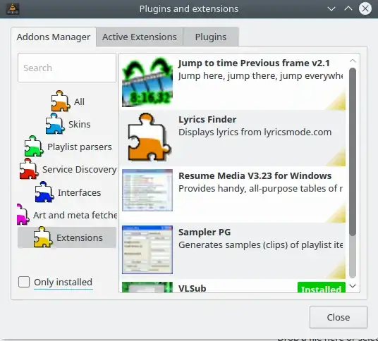

VLC 2.2. has the capability to search and install extensions within it's settings, under Tools-Plugins and extensions:
Only it doesn't always install the latest version which is needed for the extension to really work, in which case download the script from the developer (for VLSub, here) and install it as indicated in the first part of this answer.
