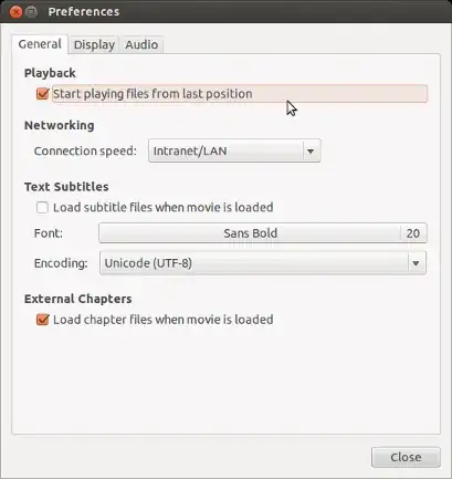

Note: In recent versions of Totem below feature sadly was removed.
Totem
The default Ubuntu movie player Totem has an option to resume playback too. This is accessible from the "Edit -> Preferences -> General" menu. Just tick "Start playing files from last posititon":

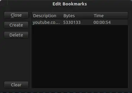

YES it is Possible in VLC , open any Video you may wish to View later ,
Pause the video where you want it to Resume to playback next time , then
Go to Menu Bar , then PLAYBACK >> Custom Bookmarks>> MANAGE and CREATE from where you want to resume for NEXT time.

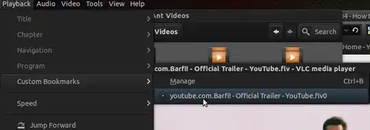

Then close the Vlc player , go to the same Video you want to Resume , then from the same above listed options ,select the Created Bookmark like in this image , and it will resume playing.

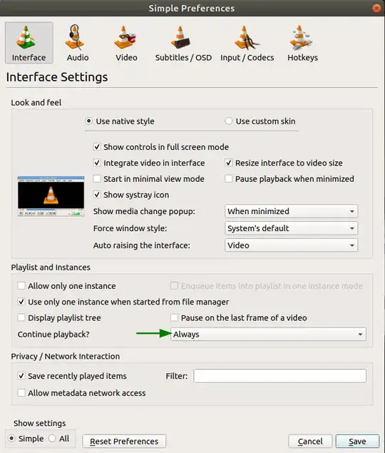

Now it's possible in a simple way (checked on Ubuntu 18.04 and VLC 3.0.4):
in VLC open Tools -> Preferences and set Continue playback? to "Always".
After that, VLC will resume playback if it was paused after 5% of the video duration.
