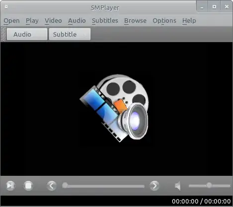

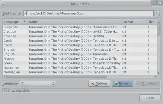

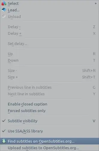

You can also try to install smplayer which provides subtitle downloading natively.
You can go to 'Subtitles' --> 'Find subtitles on OpenSubtitles.org'
and get a list of all the available sub files.
The files are downloaded and saved instantly along with your movie file ;-)

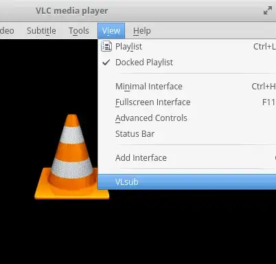

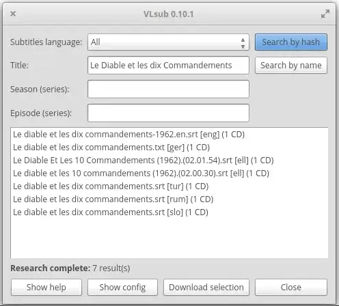

VLC/VLSub
  • VLC can do it with the addon VLSub: it comes integrated in the player after version 2.2; sometimes the integrated version may be outdated I think and you have to use the latest version of the addon from HERE or HERE, where it is actively updated, by putting the lua file in ~/.local/share/vlc/lua/extensions/. See this answer on how to install.
    It can be accessed under 'View':
screenshot
screenshot
VLSub can find and save subtitles in the video folder by instantly renaming the subtitle to match the video name. That can be configured.
The only downside is that you have to start the player and run VLsub from there, as lua files cannot be run from command line, but even that brings the advantage that while the video is open you can quickly test the subtitles. The window of the VLSub tool with the list of found subtitles stays open, and you can easily select a new one to download and load if the previous was not good. (That is a big advantage when you search only by name, and not by hash, and face the risk of getting first the wrong subtitles.)

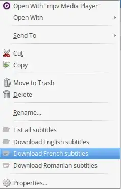

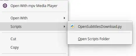

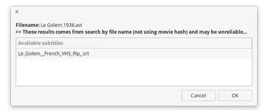

OpenSubtitlesDownload.py
"It can be used as a nautilus script, or as a regular application working under GNOME or KDE desktop environments."
For Nautilus:
git clone https://github.com/emericg/OpenSubtitlesDownload.git
mkdir -p ~/.local/share/nautilus/scripts/
cp OpenSubtitlesDownload/OpenSubtitlesDownload.py ~/.local/share/nautilus/scripts/OpenSubtitlesDownload.py
chmod u+x ~/.local/share/nautilus/scripts/OpenSubtitlesDownload.py
screenshot
screenshot
But the OpenSubtitlesDownload.py script can be used in other File managers (Thunar custom actions, Nemo actions, Pantheon-Files contract files) by adding the command
sh -c "/path/to/OpenSubtitlesDownload.py %f"
A downside that I've noticed is that (while it is said to search by both hash and name) in the list it shows it's not clear which subtitle is to be preferred; after selecting a subtitle the zenity window closes; after selecting a bad subtitle, and in order to select a new one, one must run the script again; also, it seems to be less effective in finding subtitles for series than for feature movies.

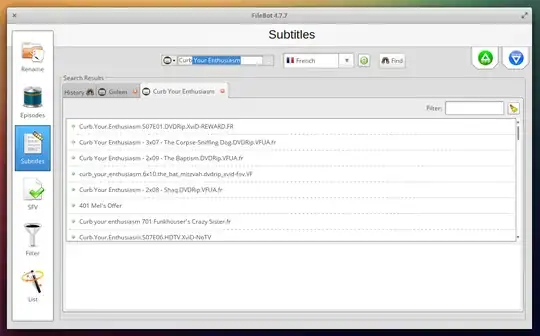

FileBot
"Tool for organizing and renaming your movies, tv shows or anime, and music as well as downloading subtitles and artwork."
screenshot
Or search by typing the name
screenshot
Downloading subtitles is only one of its options, and it is mainly centered on renaming. It needs Java to work (and the GUI version seems to specifically ask for Oracle Java to work as intended).
The GUI interface is especially useful to download subtitles for multiple videos (e.g. for series, which none of the above can do), and then the program can be used to match the names of videos and subtitles with the 'Rename' tool. It searches both by name and hash.

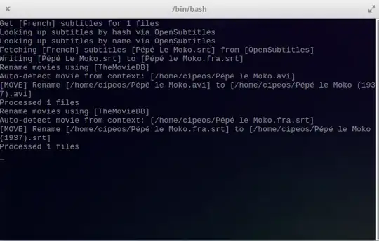

FileBot command-line version is my favorite.
The general command is filebot -get-subtitles /path/to/video/.
To search also by name (beside hash) the -non-strict option should be used.
To download English subtitles no language option is needed, but for other languages there is the option --lang with the 2 or 3 letter language code, but only one language can be specified per command, so you have to use separate commands for each language.
To rename the media files (using TMDb) and match their names, a useful option is -rename.
The command can be added to the context menu in Thunar's custom actions (or Nautilus actions, etc) by running it in a terminal; for French it should be:
gnome-terminal -e "filebot -get-subtitles  --lang fr -rename -non-strict %F"

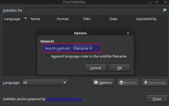

Update on SMPlayer
It searches by hash by default, but that can be changed in Subtitles-Find subtitles at...-Options.
