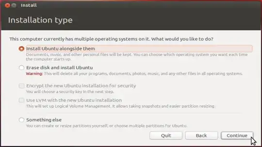

When installing Ubuntu, choose the Something Else option. (on the bottom of the screenshot below)
This will show your Windows partitions, and allow you to install Ubuntu on other partitions. See https://help.ubuntu.com/community/GraphicalInstall#Installation_type
