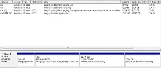

This is what I see in my Disk Manager inside Windows 7:
screenshot 1]
Click for a full-resolution image.

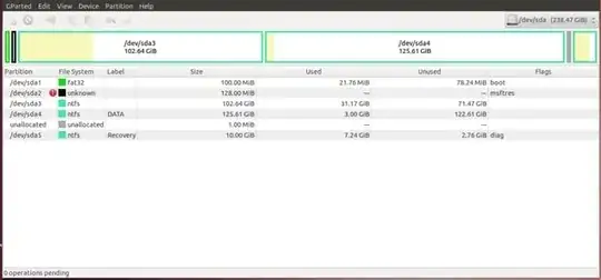

(Sorry for the Italian Language, C: basically is the partition with Windows system's file, while the D: one is for data), while this is what I see when I launch GParted:
screenshot 2
