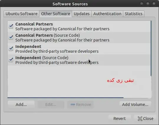

As the message says, you might have bad repositories. You can either remove them, or remove all repositories and only keep the default ones.
Run:
gksu software-properties-gtk
This will open the software sources dialog. Click on "Other Software" and remove all third party repositories.
will be like this
After that, run this command and see if the problem has been solved:
sudo apt-get update && sudo apt-get install -f && sudo apt-get update
