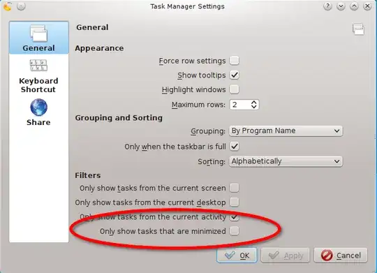

Settings
The default KDE task manager has filter setting - with the "Only show tasks that are minimized" the KDE 4.10 task manager will show the icons with the colors.
There are other task managers
Earlier: Modify KDE Desktop theme
The other task managers don't paint the minimized application icons grey.
Or use the default task manager filters
