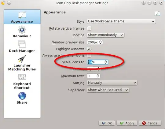

There are many task managers for the KDE.
The Icon only task manager has a scale for the icons.
:~$ apt-cache show plasma-widgets-addons
Description: additional widgets for Plasma
This package contains additional Plasma widgets shipped in the Plasma
addons module. Install it if you want a variety of widgets on your Plasma
desktop.
This package provides the following widgets:
* Binary Clock
* Black Board
* Bookmarks
* Icon Tasks

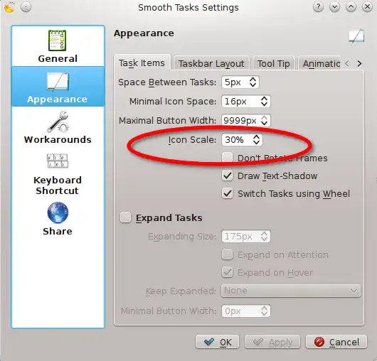

Also the smooth tasks task manager has a scale for the icons.
Package plasma-widget-smooth-tasks: http://packages.ubuntu.com/search?keywords=plasma-widget-smooth-tasks&searchon=names&suite=all§ion=all
