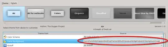

KDE System Settings > Workspace Appearance > Desktop Theme -> Details tab. Pick the opaque panel from another plasma theme. Note the panel background is not working at here. Maybe this is working there.
How it should work - tested with the KDE 4.10.2 - Air (default) desktop theme with the opaque Air theme panel
KDE System Settings > Workspace Appearance > Desktop Theme -> Details tab; Panel Background: File=/usr/share/kde4/apps/desktoptheme/default/opaque/widgets/panel-background.svgz -> Apply

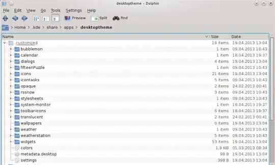

Now the selected theme with the customize opaque panel background should be copied to the ~/.kde/share/apps/desktoptheme/.customized/.
BUT this doesn't seem to work with the panel background. I tried this with the "Translucent Background" (for the other plasmoids) - it was working.

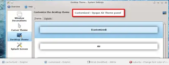

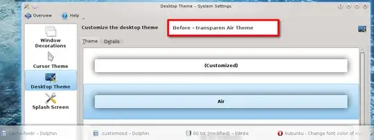

How to get the customized panel background to work (working at here)
1) Set the plasma desktop theme off from the "Customized"
2) Copy panel-background.svgz from the ~/.kde/share/apps/desktoptheme/.customized/opaque/widgets/ to the ~/.kde/share/apps/desktoptheme/.customized/translucent/widgets/
3) Remove/clean the plasma theme cache from the /var/tmp/kdecache-[username] (same as ~/.kde/cache-[hostname]). The KDE is caching things like a mad - and using the information from the cache.
4) Log out - log in (or kill the plasma desktop and restart the plasma-desktop)
The panel background should be opaque - at here it is.
