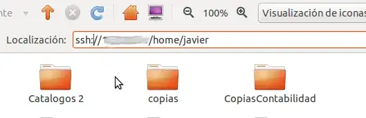

I feel that the easiest way to make a network copy is this:
  • Install OpenSSH Server Download Gwibber in the old computer.
  • Make sure that both computers are hooked to the net.
  • Open Nautilus (the file browser) in the new computer.
  • In the View Menu, check "Show Hidden Files".
  • Press CTRL+L, in the address bar type ssh://ip-of-old-computer/home/
  • You should be asked for your username and password on the old computer.
  • Copy everything that you want using the GUI.
