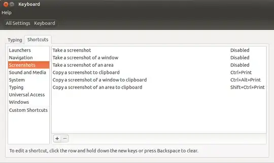

Ubuntu 14.04: for some reason neither "CompizConfig ⇒ Gnome Compatibility" nor "All Settings ⇒ Keyboard ⇒ Screenshots" worked for me. One thing that helped me was to define custom global shortcuts. I went to "All Settings ⇒ Keyboard ⇒ Screenshots" and removed all conflicting bindings on a "Print" key, which I was going to use.

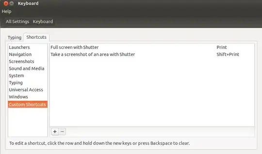

Then in the same window I opened a "Custom Shortcuts" section and created two custom shortcuts for Shutter.
  • Full screen with Shutter – shutter -f
  • Take a screenshot of an area with Shutter – shutter -s

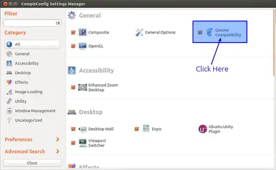

  3. Under the General Category, you would find the option called Gnome Compatibility. Click on it (not the Checkbox beside it, ie; keep the checkmark activated).
    General >> Gnome Compatibility

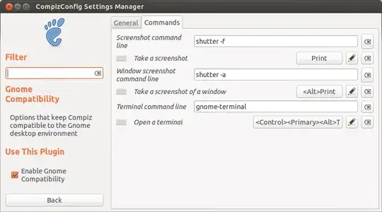

  4. Now switch to the Commands Tab and modify the text fields as shown in the following image.
    Commands Tab
  5. Explanation of previous step. You can run man shutter in terminal to see what are the different CAPTURE MODE OPTIONS available.
  • Screenshot command line: shutter -f - This captures the entire screen. Activated when you press Print.
  • Window screenshot command line: shutter -a - This captures the current active window. Activated when you press Alt + Print.

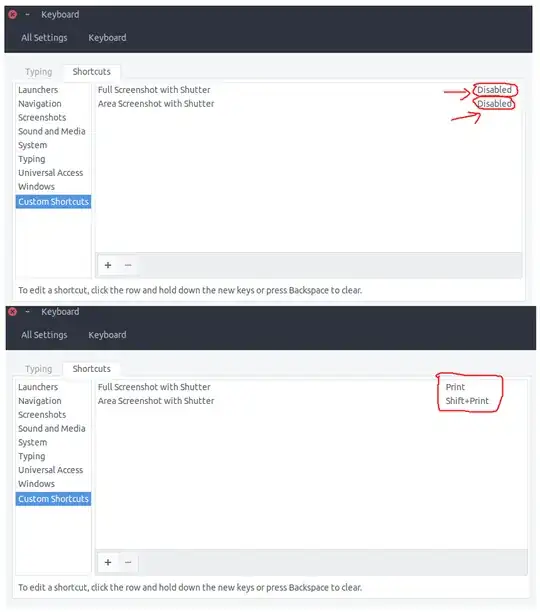

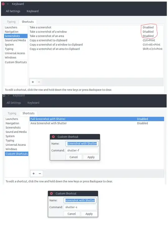

I am not using Ubuntu 15.10 Unity Distro. So the the Gnome Compatibility tool of compiz just didn't worked for me. So I used Michael's method (above). Go to All Settings -> Keyboard -> Screenshots.
pic1
Then at first disable the "Take a Screenshot", "Take a screenshot of a window" and "Take a screenshot of an area" options by clicking on the options and pressing backspace.
And then go to "Custom Shortcuts" option and click on the plus button to add a new shortcut. To create screenshot for the whole desktop write the command "shutter-f" and and to take a particular area screenshot write the command "shutter-s".
pic2
Now after creating two Custom Shortcuts you have to assign the key to these Custom Shortcuts. Click on the "Disabled" area and press the key that you want to assign to this function. I recommend to use "Print" Key for full screen captor and "Shift+Print" for an area to captor.
Close the window, and then you are good to go...
