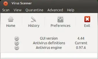

clamtk screenshot
Scan Menu: Here you can choose a file, folder or a device for scanning
clamtk scan menu screenshot
View Menu:
clamtk view menu screenshot
Quarantine Menu:
clamtk quarantine menu screenshot
Advanced Menu:
clamtk advanced menu screenshot
Help Menu: Here you can check for updates.
clamtk help menu screenshot
