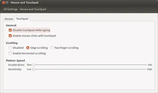

On Ubuntu, I can choose between Edge scrolling, and Two-finger scrolling. But it's a radio button, so I have to choose between one and the other.
But is there any way to enable them both at the same time? Is this limitation because of the config GUI only?
