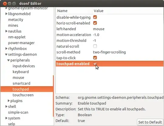

I. Check if your touchpad is enabled
Open dconf Editor, navigate to orggnomesettings-daemonperipheralstouchpad and make sure that tauchpad-enable is enabled/ticked (check also the other options):
enable touchpad
