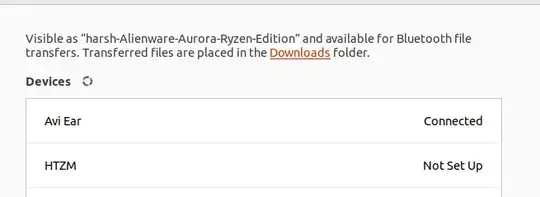

Connect your headphones to Bluetooth Properly
We will use the bluetoothctl command-line utility:
  • Important: Make sure your device is bluetooth discoverable by pressing some button on the device.
  • Find the bluetooth device's MAC-address by running $bluetoothctl scan on.
    • This command will start discovering your devices and you need to spot your device's mac address in the output. My device is called "Avi Ear" and it was found in the line:
      • [CHG] Device 4C:87:5D:9E:04:B8 Name: LE-Avi Ear
    • From the above output, we know that my device's MAC address is 4C:87:5D:9E:04:B8.
  • Now that we have the MAC address, we can connect to the device with the following bash script AFTER replacing my MAC address with yours:
    • Important: Before running the script, make sure your device is bluetooth discoverable by pressing some button on the device.
#!/bin/bash
# remove headphones and start fresh
bluetoothctl remove 4C:87:5D:9E:04:B8
# turn bluetooth off
bluetoothctl power off
# turn blutooh on
bluetoothctl power on
# scan for devices for 15 secs so that our device gets discovered.
timeout 15s bluetoothctl scan on
# pair with headphones
bluetoothctl pair 4C:87:5D:9E:04:B8
# trust headphones
bluetoothctl trust 4C:87:5D:9E:04:B8
# connect to headphones
bluetoothctl connect 4C:87:5D:9E:04:B8
  • Finally, you should see headphones in the "Connected" state in Bluetooth Settings. For example, as you can see in the image below, "Avi Ear"(Name of my headphones) is "Connected". enter image description here

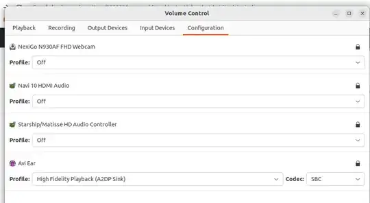

Configure your computer to output to your headphones
Even though my headphones were shown as connected, I did not hear any sound. To hear sound you need to:
  • Open the PulseAudio Volume Control App. This came preinstalled with Ubuntu for me, but you should be able to find easy instructions to install if you don't have it.
  • Go to the Configuration tab and make sure you have all other devices turned off except your headphones like this: enter image description here
You should now be able to hear sounds from your headphones now.
