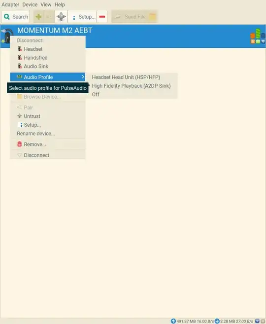

  2. Edit the Bluetooth settings, select audio profile "Headset Head Unit"

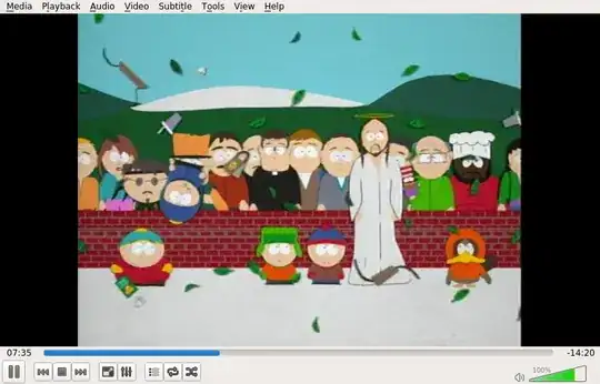

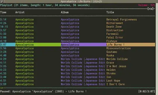

  1. When the headset and the computer autoconnect, the computer will use the most recent profile (High Fidelity Playback). However, VLC will play muted audio, and MPD will be persistently paused.

  2. You can see in the images that there are three options: "Headset", "Handsfree" and "Audio Sink". It does not seem to matter which one I click.
Here are screenshots with descriptions.
Available menu options in Bluetooth:
Persistent pausing in MPD. I can move forward or backward, but there is no "play" option:
VLC will happily play with no audio:
