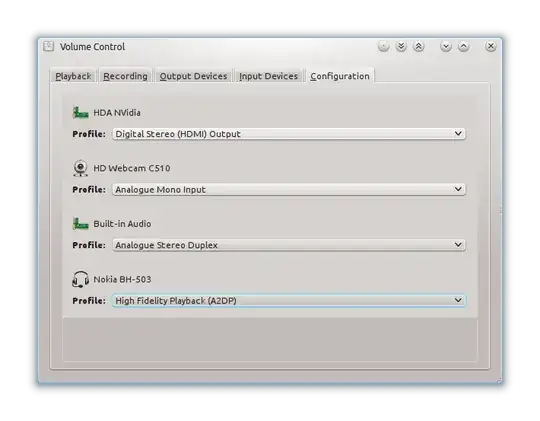

Try installing pavucontrol, start it up (PulseAudio Volume Control), and reselect the A2DP profile used for your audio device there in the tab 'Configuration'. It should remember the profile the next time you plug in (or connect for Bluetooth).
Screenshot of pavucontrol for A2DP profile selection.
