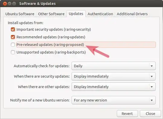

Go to System settings > Software & Updates, select Updates tab and check Pre-released updates.
