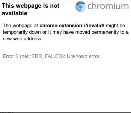

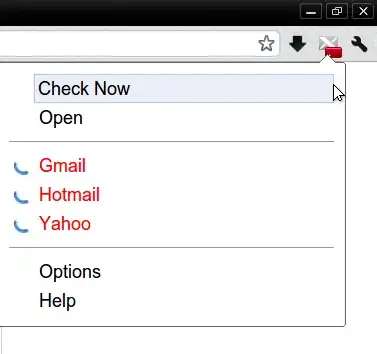

It just keeps checking in vain.
Also cannot import or export data, but get this error
I use the latest versions of both in Lubuntu 12.04.
In Google Chrome it works.
What could it be the problem?

The X-notifier blog says that the latest version of that addon needs version 21.x or later of Chromium, one that at this stage is not in the official sources.
In the future it will be, hopefully.
But this problem might reappear for future versions,as future addons/extensions may keep asking for newer versions of the browser, in which case see unofficial sources or beta and dev versions.
So, see How to install the latest stable version of Chromium? (including unofficial ones) and How do I get the latest (beta and development) version of Chromium?
