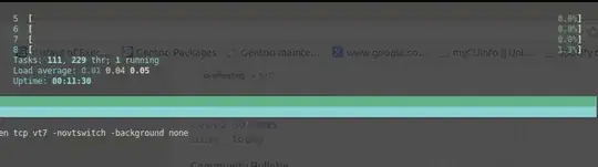

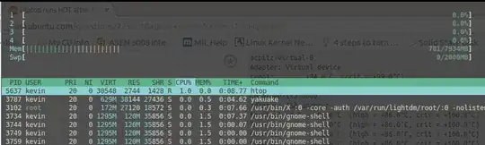

Edit 1:
Per @Paul's suggestion, I ran htop to try to narrow down the problem. Here is the result!
Left side of terminal
(left side of terminal)
Right side of terminal
(right side of terminal)
This is about 10 minutes after boot-up, htop, yakuake, and a chrome page with 1 tab opened to this question are all that I have manually opened. The most taxing program to the CPU is htop itself. I think that the problem must lie elsewhere; my temps are already up to ~65C for the CPU and ~69C for the GPU, with nearly 0% CPU usage.

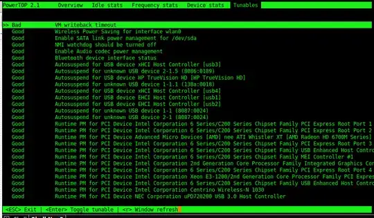

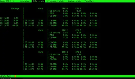

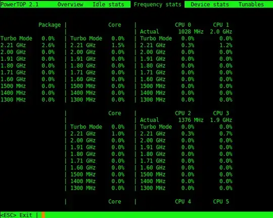

Edit 2:
As requested by @psusi, here is the output of 2 tabs from powertop (changed my colors for readability):
Again, all I am manually running is one google-chrome tab and a yakuake terminal. I am fairly new to powertop, so I am unsure how to interpret this. Let me know if you need info from the other tabs.

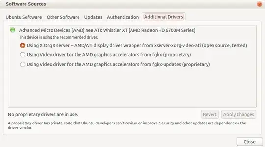

Edit 4:
@Arup Roy Chowdhury mentioned that my AMD drivers might not be installed correctly. I am currently using the following driver (output from software-properties-gtk):
Should I be using a proprietary driver instead? The gnome-shell seems to be running graphics acceleration OK with the open source one.

FIXED!!:
Problem solved. Thank you to @DrA7 and @YellowApple to pointing me in the direction of graphics card problems. I found this wonderful question and implemented @Nick Andrik's solution. In a nutshell, installing the proprietary drivers (fglrx-updates) from ppa:andrikos solved the problem. I can now use ATI Catalyst to choose my power mode and which graphics card (Intel or AMD) I want to use. My temperatures are down to ~44 degrees and battery life is up to ~4 hours again. I also installed Jupiter, which improved battery and temperatures further.
The open source drivers for AMD seem to be getting better, however it looks like their support for hybrid graphics cards (like mine) is not quite up to spec. Use the proprietary drivers for now.
