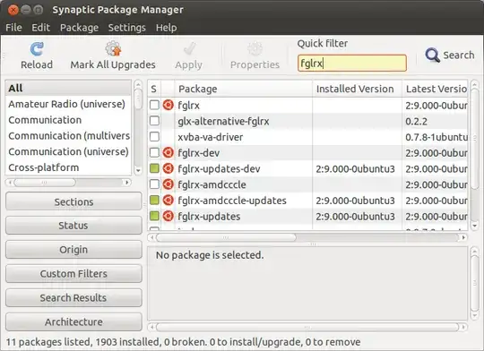

So I installed Synaptic package manager and installed fglrx-updates from there
Now the Catalyst control centre was installed.

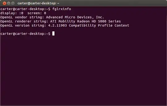

So I applied nomodeset and this time it booted with Unity present
Here is the result of fglrxinfo

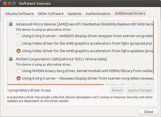

And here is what software sources says
With nomodeset applied I might not be getting the splash screen on boot up but fglrx-updates is working well. I would go as far as to say that it is performing better than it was in 12.04
