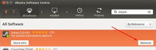

Removing Steam using the Ubuntu Software Centre:
  1. Open the Ubuntu Software Centre, by clicking on the appropriate icon in the launcher, or opening the dash and searching for it.
  2. Search for "Steam" in the Ubuntu Software Centre.
  3. Select it, and click "Remove"
This will remove Steam from your system. Only system files, however, will be removed, user files will not. For most programs, user files are very small and not worth worrying about, but for Steam, they include all your downloaded games, and can be quite large. To delete your user files:
