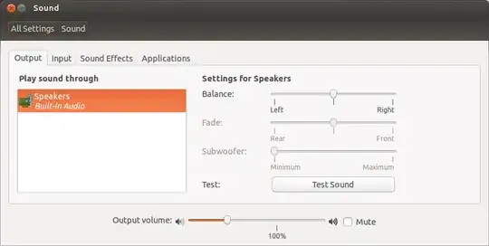

I have a Dell Inspiron 17r, after a fresh install of 12.10, the subwoofer seems to be not utilized. No sound comes from it and in the Sound Control Panel the settings appear grayed out (see screenshot). How can I activate the subwoofer?
no subwoofer

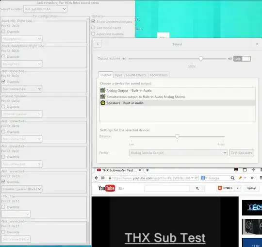

This configuration worked for me.
Basically using HDAJackRetask (from the package alsa-tools-gui) using Internal Speaker (Back) for Pin 0x10 and from and a specific device Output (Sound configuration). The profile "Test Speaker" doesn't show the subwoofer, yet I tested it with https://www.youtube.com/watch?v=PC7WEQsiz08 and the vibration is noticeable and the depth of the music sound is very good.
All is summarized in this screenshot:
alltheconfiguration
