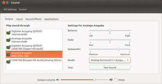

Have you looked into the sound menu? There should be an option to change the mode, it is probably just set to stereo while higher modes are available. enter image description here
If that doesn't fix your issue you should run alsamixer in terminal and check the options there.
