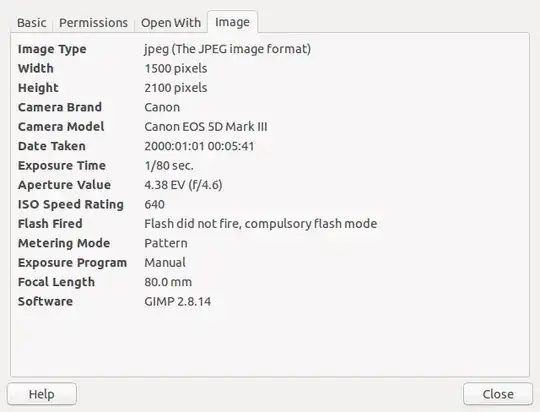

Let's say I have this picture with 2.3 MB (2 261 588 bytes) file size and:
list of image properties shown in file manager

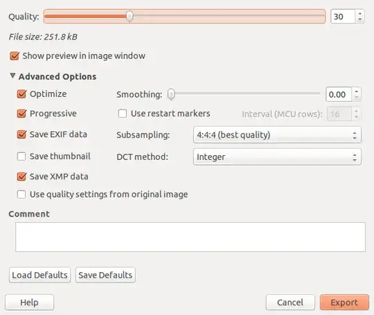

After opening the file in GIMP 2.8 in order to just export a copy and use the JPG Export dialogue box to reduce the quality of the image to 30%:
image size dialog

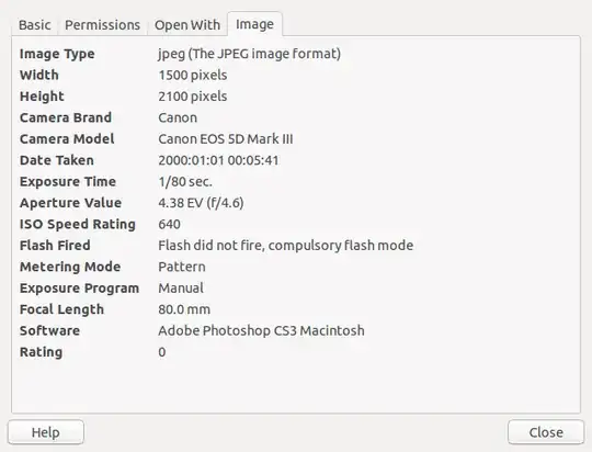

I get these properties in the image copy (251.8 kB (251 797 bytes) file size):
list of image properties in file manager

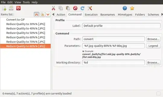

The problem is happening when I try to batch process several image files, which results in the first file name cloned into several file names containing a different image each one. With the properties I set in this set of commands:
Nautilus Actions dialog
Basically, each Nautilus Action is using these parameters:
Command: convert
  • From (imagemagick)
Parameters: %F.jpg -quality 80%% %F-80q.jpg
  • Which is interpreted as: convert path/to/file1.mid.jpg -quality=80% path/to/file1.mid-80q.jpg
Working directory: %d

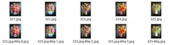

thumbnails
Here we can see each image processed in a different file but just the first file name is used to assign the new names to the copied files. I want a result like:

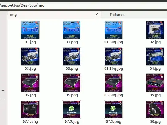

More specifically it solves the file names problem. Nevertheless, I also expected to get smaller file sizes by running the proper convert file.jpg -quality 30% command and it is dropping bigger file sizes as you can see:
file size
Does anyone know if there's something else I should add to the parameters seen in muru's answer? I appreciate a lot your efforts to provide help on this issue.
