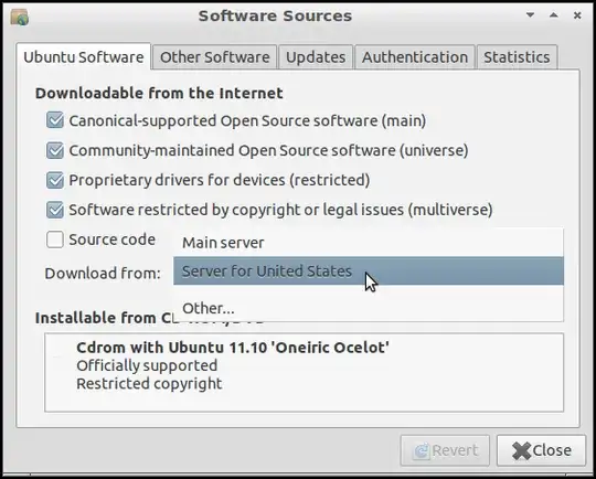

Change the Download Server
In the Ubuntu Software tab of the Software Sources window, there is a drop-down menu labeled Download from. Select your regional server. For example, I'm in the United States and it looks like this on my 11.10 machine:
Software Sources window showing Server for United States being selected in the drop-down menu.
Software Sources window showing Sever for United States being selected in the "Download from" drop-down menu.
You may see other servers listed in that short list (like the server you currently have set up).

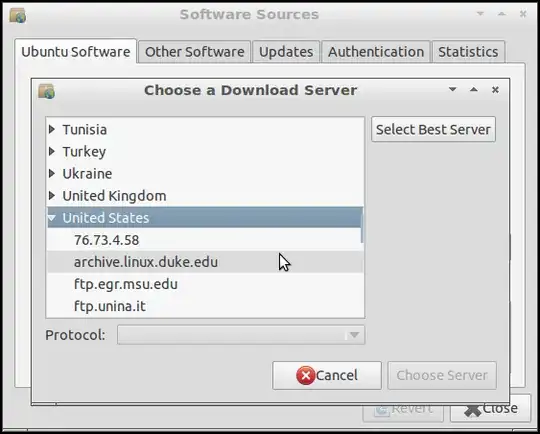

If you want to use another mirror, you can look through a list of mirrors by clicking Other....
Choose a Download Server dialog in Software Sources, for picking an alternative mirror
