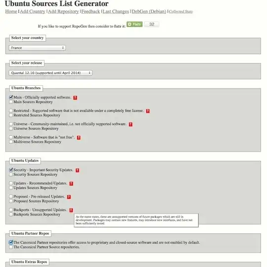

This website will also help you generate a sources.list : http://repogen.simplylinux.ch/index.php
