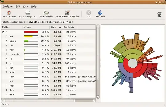

The Disk Usage Analyzer is available under Ubuntu > Accessories > Disk Usage Analyzer. It provides you with a snazzy pie graph showing what files and folders take up the most space:
The documentation on it is a little sparse, but you can find more information on the Ubuntu wiki, and the project page.
