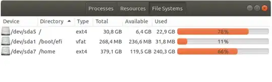

GNOME System Monitor
If you prefer graphical gnome-system-monitor:
screenshot
Disk Usage Analyzer
screenshot
The Disk Usage Analyzer counterpart for CLI would be ncdu.
