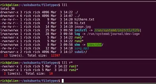

I'm conditioned to the ll command which is aliased to ls -alF. It is just missing a file count and size of files at the bottom. I played with du and tree but could not get the totals I needed. So I created lll to do that for me.
In your ~/.bashrc place the following:
lll () {
    ls -alF "$@"
    arr=($(ls -alF "$@" | awk '{TOTAL+=$5} END {print NR, TOTAL}'))
    printf " \33[1;31m ${arr[0]}\33[m line(s).  "
    printf "Total size: \33[1;31m ${arr[1]}\33[m\n"
#    printf "Total size: \33[1;31m $(BytesToHuman <<< ${arr[1]})\33[m\n"
Save the file and resource it using . ~/.bashrc (or you can restart your terminal).
Sample output
The nice thing about ll output is it's colors. This is maintained with lll but lost when using find or du:
TL;DR
A bonus function you can add to ~/.bashrc is called BytesToHuman(). This does what most console users would expect converting large numbers to MiB, GiB, etc:
function BytesToHuman() {
# https://unix.stackexchange.com/questions/44040/a-standard-tool-to-convert-a-byte-count-into-human-kib-mib-etc-like-du-ls1/259254#259254
read StdIn
b=${StdIn:-0}; d=''; s=0; S=(Bytes {K,M,G,T,E,P,Y,Z}iB)
while ((b &gt; 1024)); do
    d=&quot;$(printf &quot;.%02d&quot; $((b % 1024 * 100 / 1024)))&quot;
    b=$((b / 1024))
    let s++
done
echo &quot;$b$d ${S[$s]}&quot;
} # BytesToHuman ()
Next flip the comment between two lines in lll () function to look like this:
#    printf "Total size: \33[1;31m ${arr[1]}\33[m\n"
Now your output looks like this:
As always don't forget to re-source with . ~/.bashrc whenever making changes. (Or restart the terminal of course)

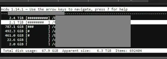

One can use 7z (sudo apt-get install p7zip-full) to determine the total apparent size of a directory from the command line. Example:
7z -mx=0 a temp16584.zip /path/to/directory
It will show the total size of a directory (as well as the number of files):
(base) user@server:~$ 7z -mx=0 a temp16584.zip /path/to/directory
7-Zip [64] 16.02 : Copyright (c) 1999-2016 Igor Pavlov : 2016-05-21 p7zip Version 16.02 (locale=C.UTF-8,Utf16=on,HugeFiles=on,64 bits,8 CPUs Intel(R) Xeon(R) Platinum 8275CL CPU @ 3.00GHz (50657),ASM,AES-NI)
Scanning the drive: 7829 folders, 684576 files, 6914280912739 bytes (6440 GiB)
Creating archive: temp16584.zip
Items to compress: 692405

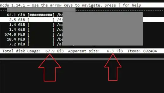

To get both the actual and apparent total size of a directory, one may use ncdu (sudo apt-get install ncdu):
Keyboard shortcut in ncdu to toggle between showing disk usage and showing apparent size: a. Same folders as above but now showing the apparent sizes for each folder:
