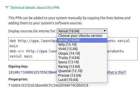

As commented by user535733, this PPA has no package for Ubuntu 17.10. You can check the supported Ubuntu versions on the PPA page by expanding Technical details about this PPA then clicking the dropdown list.
  • The Unable to locate package error is shown when the requested package wasn't found in any package list.
  • The package lists for a PPA are located in a subdirectory of <repo-base-url>/dists/<ubuntu-code-name>/.
As you can see on the PPA page, under Technical details about this PPA, the repository base URL is http://ppa.launchpad.net/jre-phoenix/ppa/ubuntu. If you navigate to the dists directory you'll wont find the artful (Ubuntu 17.10 code name) directory. That's why the pgl* packages are not known to the package manager.
I don't know why you think you need arm packages, but even if you do the PPA provides arm packages for the supported Ubuntu version.
