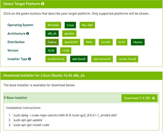

The installation guide says to run the following command:
sudo dpkg -i cuda-repo-<distro>_<version>_<architecture>.deb
But how should I fill distro, version and architecture?
If you use the CUDA downloads website and selected the appropriate options (say Linux, x86-64, Ubuntu, 16.04 in order), it will show the exact command you're supposed to run:
  • The distro is Ubuntu (16.04 or 14.04 depending on what you're using, run lsb_release -cd to find out).
  • The version is based on the CUDA release you're downloading.
  • For the architecture, see How to find architecture of my PC and Ubuntu? - use uname -m.
