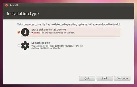

Since you want to remove Windows and install only Ubuntu, you'll have to choose C: while installing Ubuntu. There will be a window like below while installation and there'll be plenty of other options in your case and I guess you'll be able to choose to remove Windows and install Ubuntu.
If not, you'll have to manually select the partition containing Windows and install Ubuntu on it.
