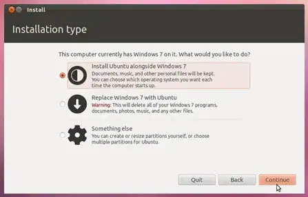

Install Ubuntu with the usb/dvd. When you reach the partitioning part, Ubuntu installation
choose for "Something else". Then format the Windows 8 x64 partition and select as "/". After installation, create a shortcut on your desktop to your NTFS partition or add it as a bookmark in Files (Nautilus).
