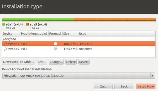

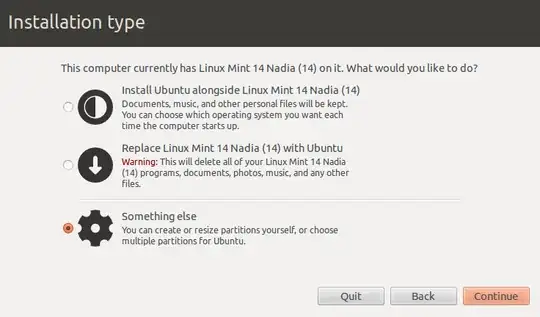

No you won't loose your data. Here are the steps you should take:
Choose installation type

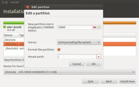

Let's assume that your C:/ drive is sda1, click on the Change button.
A window will pop up. Here you can set the size of the partition, its type and mount point. Check the box Format the partition, use Ext4 and Mount point: / which means root.
