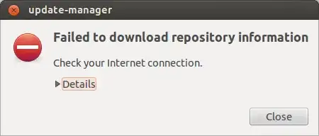

I tried installing VLC Player yesterday, and I got the Requires installation of untrusted packages error. I searched for hours for a solution to this problem, and finally came upon a suggestion that said to change servers for downloading updates from. I did this, and it gave me a 404 error when I clicked on "Check" in the Update Manager. I tried switching my server back to the main one (and after that, several other ones), but I am now still getting a 404 error: enter image description here

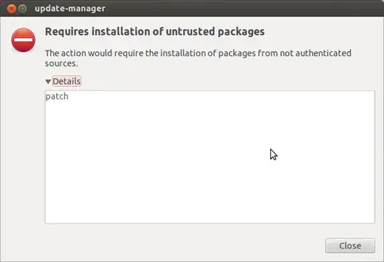

And the other error I get when downloading or updating: enter image description here
