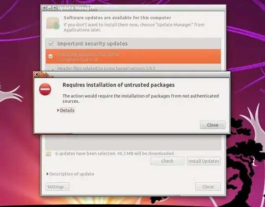

It didn't fixed the error. So, how do I fix my GUI update?
For every software I have to install it from command line because I got same error when install software from Ubuntu Software Center.

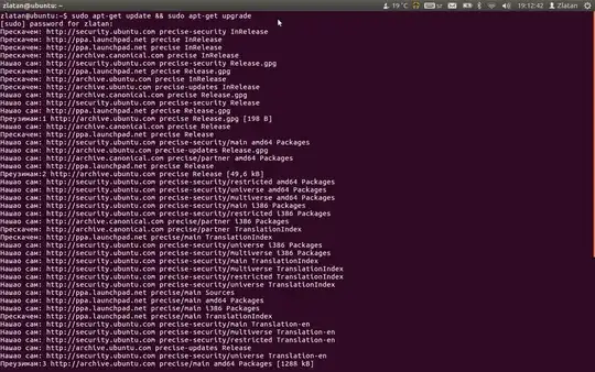

  1. Write in a terminal: sudo apt-get update && sudo apt-get upgrade or edit Update Manager settings (try this first if you have already configured Update Manager).
    CLI
  2. Launch Update Manager and try again.
    GUI
Running update through a terminal gives option whether to allow or disallow untrusted packages.
WARNING: The following packages cannot be authenticated!
  playonlinux
Install these packages without verification [y/N]?
If you trust the package source, type y.

In answer to your question, you cannot "fix" the GUI update (i.e. Update Manager), because it is apparent that that application does not currently have the capability of installing untrusted packages. If you want to install untrusted packages, you must do it at the command line.
There are, however, two ways you can stop Update Manager from reporting this error: either remove the untrusted software from your system OR trust the repository in question, as outlined in the answer to the other question ( Updates don't install because of "untrusted packages" ).
