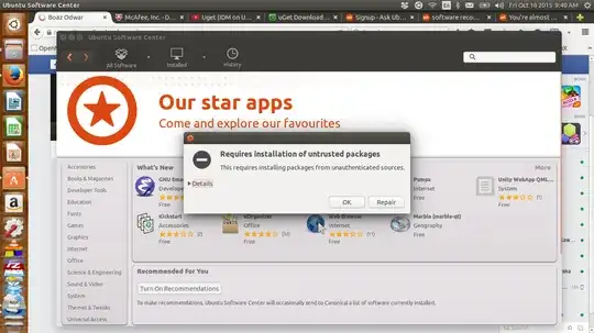

Hi, I am trying to install uget and I get this error message "This requires installing packages from unathenticated sources" and there are only two options. Ok and Repair, and even if i click both their is nothing happening. It keeps on popping up. I am using Ubuntu 14.04 64bit
Please help.
Thank you.

Remove the repository and re-add it again:
  1. Remove the repository
    sudo apt-get install ppa-purge
    sudo ppa-purge ppa:plushuang-tw/uget-stable
  2. Add the repository
    sudo add-apt-repository ppa:plushuang-tw/uget-stable
    sudo apt update
  3. Install uget
    sudo apt install uget
