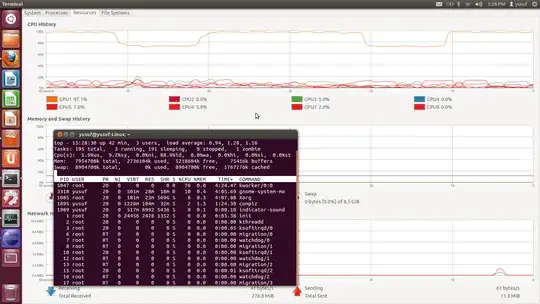

I recently installed Ubuntu 12.04 on my Samsung laptop alongside Windows 7. Whenever I use Ubuntu (even when its idle) kworker uses almost 90% of one of 8-cores. Even though it doesn't really affect my usage, it bugs me and I am afraid of that it might harm my processor. I even tried installing another Linux distro (Linux Mint), and kworker caused the same problem. So I don't know what to do. I would really appreciate your help.

The CPU usage seems to be normal, there's only 1 CPU (CPU1) that has high usage. In all there are total 3 process that are in the running state two of them being kworker and gnome-system-mo (the first 2 processes in the top command screen short you added).
"kworker" is a placeholder process for kernel worker threads, which perform most of the actual processing for the kernel, especially in cases where there are interrupts, timers, I/O, etc. These typically correspond to the vast majority of any allocated "system" time to running processes. It is not something that can be safely removed from the system in any way, and is completely unrelated to nepomuk or KDE (except in that these programs may make system calls, which may require the kernel to do something)
