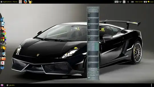

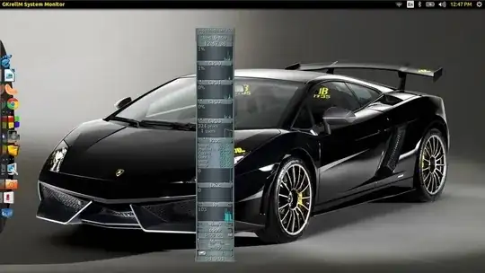

The high cpu usage would mostly likely be attributed to cpu/gpu interactions mainly due to the compositing and the stock window manager; running somewhere north of 300 processes 'out of the box' at start up. As an alternative install openbox, which will then become your window manager. By doing so you drop your cpu processes in idle stat from around 320-380 to ~250-290 or less. You can use a Ubuntu like desktop only it will run with the openbox window manager.
Also install gkrellm. Its a realtime system monitoring application written and maintained by Bill Smith and company. It real-time reads the kernel's output. You can monitor your system processes with it and find out what works best for your machine.
These pics are of gkrellm which shows the difference in the processes via both dTop environments.
UbuntuDtop
OpBxBuntu
The Ubuntu Desktop environment relies heavily on python. Disabling it would lead to false output.
Good Luck! Don't join the darkside! The force is with Ubuntu!
